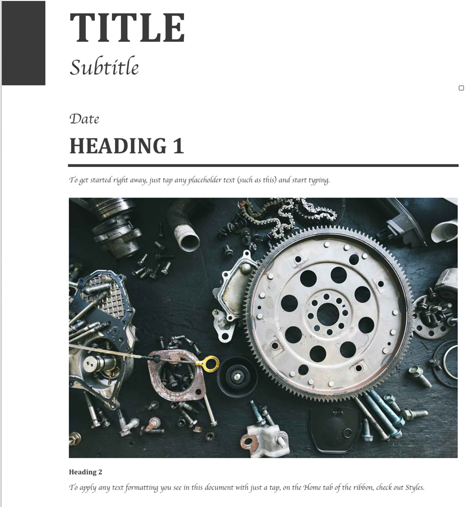

    Furthermore, the behavior I describe is not consistent between different templates. Here I try this with a new fresh template, "Catalog".
    HERE'S THE TEMPLATE'S DEFAULT APPEARANCE.  ALL HEADINGS ARE BASED ON "NORMAL":

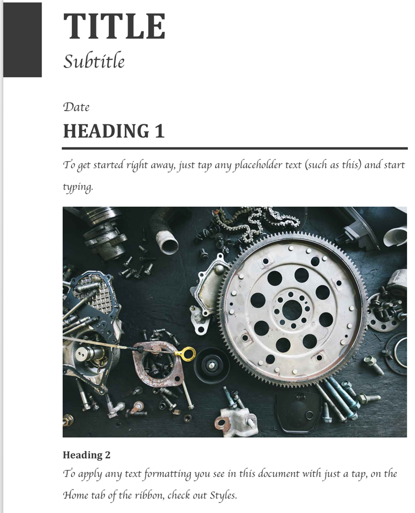

    HERE'S WHAT HAPPENS WHEN I CHANGE NORMAL'S TYPEFACE.  NOTE THAT THE "SUBTITLE" AND "DATE" HEADINGS CHANGE, WHILE THE OTHERS ARE UNAFFECTED :

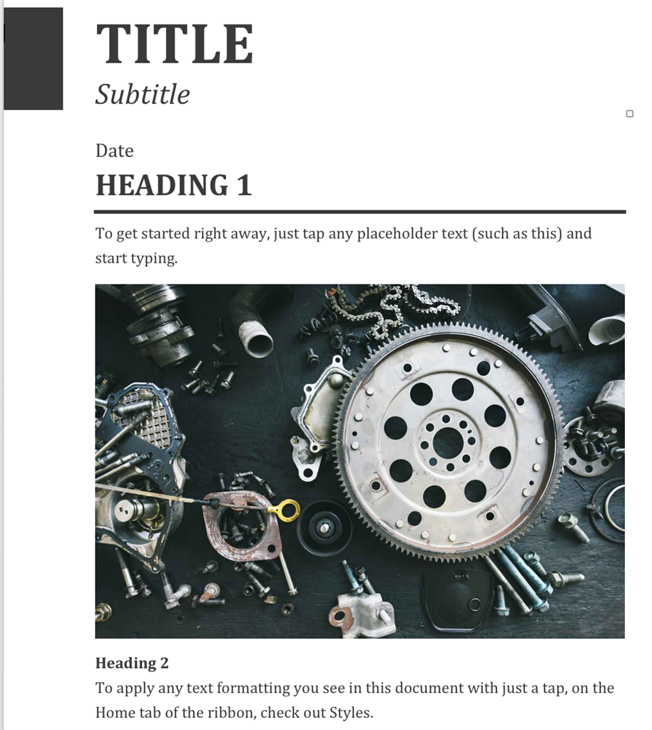

    AND HERE'S WHAT HAPPENS WHEN I ADDITIONALLY CHANGE NORMAL'S FONT SIZE.  IN THIS CASE IT'S ONLY HEADING 2 THAT'S AFFECTED; THE OTHERS ARE UNCHANGED.  CAN OTHERS WHO HAVE MACS PLEASE TRY REPLICATING THIS BEHAVIOR?
