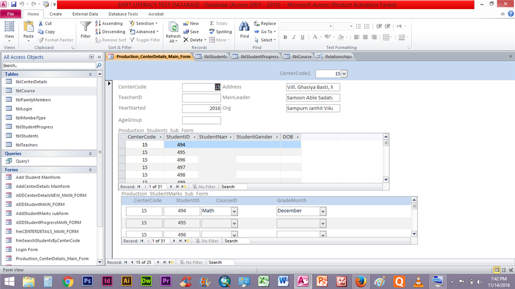

    OK, first, I don't really see the need for the first subform, but it does no harm to be able to view a list of students for the selected Center.
    However, editing the Recordsources is not the way to go. As long as you set the The Linked fields properly for each Subform, then they should reflect the Selected record on the main form. did you use the subform wizard to embed the subforms? Did you select the Centercode as the linking fields?
    As for entering the grades, You do thay in the second subform. You should have a combobox to select the Student, you already have a combo to select the course and month. Now you just need a textbox to enter the grade.
    I'm still not clear, is it 100 marks for the period spread out over each course?

    I've done a lot of hard work since your last instructions on the form. I have it to the point where both the sub forms are in sync with the combo box on the main form. For example, if I select a center code from the combo box on the main form, both the sub forms filter to reflect the center codes. The way I did this was I edited the record sources to reflect only what I needed to show on the form and filter the results.
    Please have a look at the screenshot and let me know how I fared?
    Now, I need to know how to give marks to each student in the second sub form. I have made a combo box in the second sub form for the user to select the course and grademonth. The user sees the name of the course, what what really gets stored is the value associated with the combo box.
    Please discuss any mistakes I've made in the design and also a way to enter the marks of the students. Each course is of 100 marks maximum and out of that the instructor has to allot marks in each subject.
