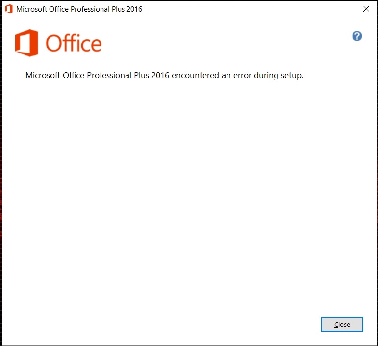

I have tried to install the Office on Windows 10 Home but unable to complete it. almost nearly at the end the installation process rolls back and an error message "Microsoft Office 2016 Professional encounter an error during setup" appears. I have read the thread on this same issue and have tried everything suggested there but to no avail. I had a working office on this same machine previously but due to some reasons I had to recover my windows to it's factory defaults. After that I am unable to install the office at all. Any help guys, i am attaching the screenshot of the error.

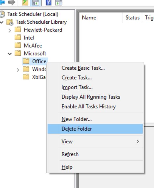

I have found a solution to the problem and it calls for you to go into the scheduled task and delete the Office folder in that and then try to install Office. Try this...

It was erroring trying to register a scheduled task but was complaining that the system could not find the path specified.  After tracking with procmon I verified the XML file used for this command was actually being created.  I then focused on the other path mentioned in that error:  "Microsoft\Office\OfficeTelemetryAgentLogOn".
This is the path the scheduled task would actually live at so I opened Task Scheduler and drilled down through the path.  I found my path ended at "Microsoft\Office" and there were 0 tasks here.
Since this path was empty, I deleted the Office folder entirely from Task Scheduler and re-ran setup again.  This time it finished successfully!
I don't know why the simple fact that the Office folder existed within Task Scheduler prevented this from running but its removal fixed my issue.

    THANK YOU!!!
    Deleting the "office" folder (Microsoft>Office) under task scheduler worked for me.
