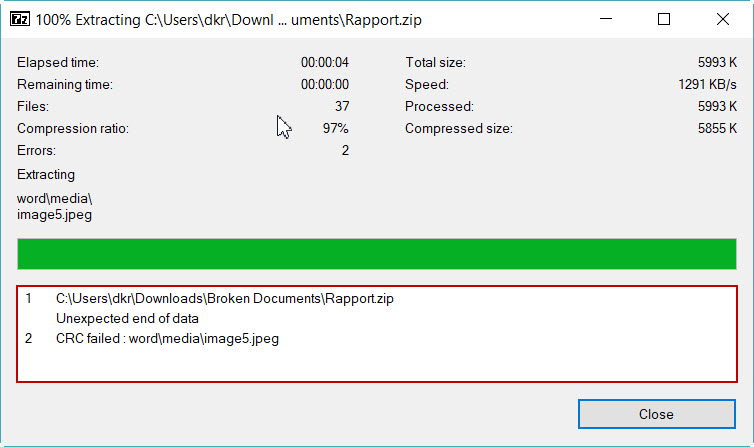

  2. Doug Robbins - MVP - Office Apps and Services 323.6K Reputation points MVP Volunteer Moderator
    2018-01-04T23:45:24+00:00
    Was your document saved to a USB drive or some other form of removable media.
    After changing the file extension to zip so that the components of the document can be extracted from the archive, the essential document.xml file that contains the text of the document is not present.
