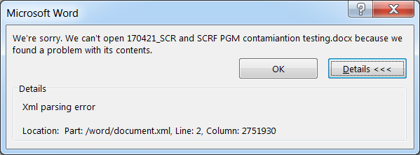

Hello, I'm having an issue with one workstation producing this error opening a docx file:
Details
Xml parsing error
Location: Part: /word/document.xml, Line: 2, Column: 2595814
I can open this file on two other workstations with no problem. I've done a reinstall of Office and I tried copying the file locally to eliminate any access issues. I've read other posts about this error but they pertain to the document being corrupted in which case it wouldn't open on any workstations.
Thanks!

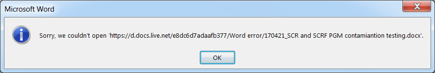

    2017-05-24T13:26:12+00:00
    When I tried to open this document in word on my PC it comes up with the following error message :
    And when I try to open the copy of the file I have on my PC it comes up with the following one:
    It works fine on some of my colleagues PC but not on some others.
