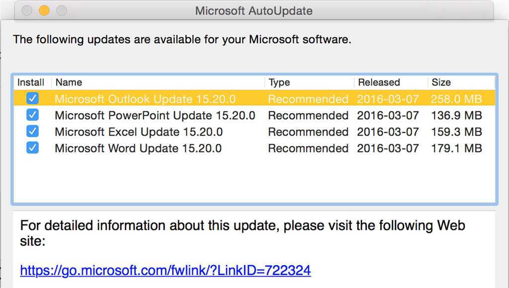

    Now that AutoUpdate 3.4 (160315) is installed, it prompted me to re-download all the Excel/Outlook/PowerPower/Word 15.20.0 updates that were published back in on March 7th.  I have already running these versions on Mac OS 10.10.5 Yosemite since the week they were released.
    Did this happen for anyone else already running 15.20?  I wonder if AutoUpdate is malfunctioning seeing has how it erred out in the first place.
