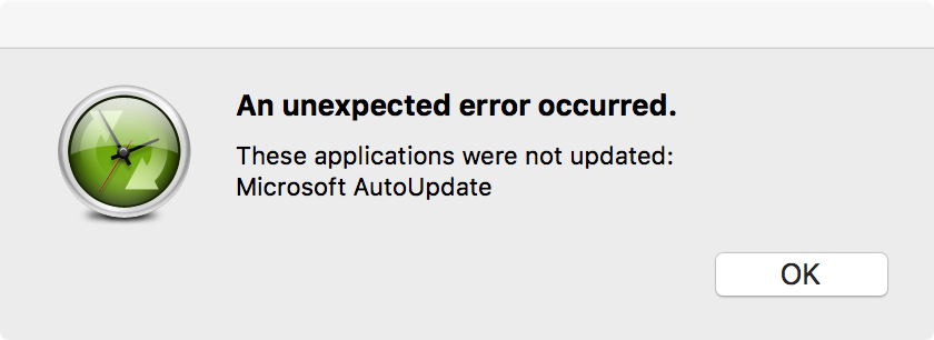

I have just been advised by AutoUpdate of this Update to the program but it will not download. I get "An Unexpected Error has Occurred" warning after a period of time. It is as if it has Timed-Out

Try this workaround:
Go to system preference - network - advanced - DNS
Add 8.8.8.8 and 8.8.4.4 to the DNS server.
select OK - Apply.
Then try running the update.
Hope this helps...
Fabulous work thanks you TherenceK - worked a treat

    Since the 16th March 2016 update offers AutoUpdate 3.4.0 (again and dated 7th March) my autoupdate is failing with the following:
    The update downloads okay but appears to fail during the install.
    I have tried changing DNS (to 8.8.8.8) though I am not sure how that would help once the file has been downloaded. I have also tried re-downloading and installing manually the AutoUpdate for Mac 3.4.0 file from January. Although that installed, once I run autoupdate I get the same issue.
    Any assistance would be greatly appreciated. I hate when things break for no apparent reason.
