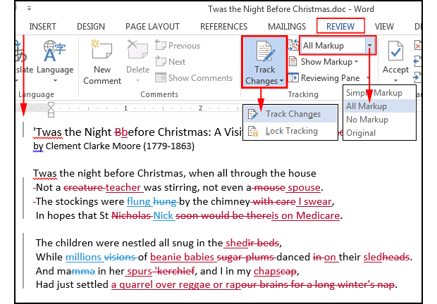

    SOLUTION (in my case): select "All Markup"
    One option is not mentioned here, and it's very basic: my standard installation is showing "Simple Markup" in the REVIEW settings pane, and it should read  "All Markup":
    After timeless searching and testing, the solution was closer at hand than ever imagined...
    I hope this helps some more 'victims' of this shortcoming in Word 2016.
