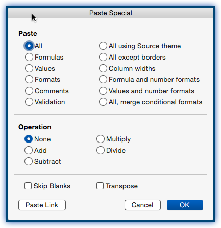

    1. Open a New document in Excel.
    2. Switch Back to original, and copy only those cell which has content in them.
    3. Now switch to blank Document.
    4. Go to File Menu and choose Paste Special.
    5. When in Paste Special (if Setup similar to Excel 2011) then from list Choose:
    Formulas and Values only. Reformat Column or Row Formats as needed. 6. Now save under new name. 7. Try manipulating new document. (on your Machine). If works then you had some type of corruption which would slow down or kill a Document (Spreadsheet or Database).
