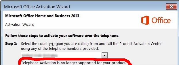

    An interesting development. I now absolutely refuse to supply oem/retail versions of Office 2016. I have become very good at convincing my many small clients to use Open or Libre office along with eM Client for email. But i have about 10 sealed packs of old stock "Home and Office 2013" packs for the odd requirement. So today I needed to use one and I broke the plastic, installed the product and tried to activate. I got "This product has already been activated". Now this is an item that was purchased from an authorised Microsoft channel partner and leftover stock from a purchase of 50 units, the previous 40 of which activated without a hitch. I cracked open a second pack and had exactly the same problem. So I tried the phone activation option and what do I see first: "Telephone Activation is no longer supported for your product"
    I knew the number so I dialed it anyway and tried to activate the product. After typing in all the numbers I was told that the product could not be verified and was transferred to a person. I asked how it was possible a sealed pack could have been activated already to which he answered that he saw no problem with the product and was able to give me a code that allowed the activation to proceed. He said he was unable to comment on my issue as he was merely following a procedure.
    Is Microsoft trying to make things difficult with the last line of Product Key products? No telephone activation support and bogus "already activated" messages...

    Yes, MS is doing everything it can to "encourage" users to "upgrade" <sneer> to Office 365.  Lets take your issues in reverse order.
    The no phone activation "error" is a "known issue" that MS is doing nothing, or at least the absolute minimum about. Phone activation is allowed, you just need to know the secret. Here it is:
    2017 01 20- "Telephone activation is no longer supported for your product" error when activating Office
    MS oops'd, and just hasn't bothered to fix the problem in much too long.  A MS staffer provided an "explanation" and a link (in green) to a page with a link to get the phone number for your specific geographic location
    <snip https://answers.microsoft.com/en-us/msoffice/forum/msoffice_install-mso_win10/how-to-reinstall-office-home-and-student-2007/fcd910a6-c4cf-4739-9cf2-1dc5b39e7e53?msgId=725b5bc7-f577-4366-9a33-3ba29d67f3dd >
    Michelle V [MSFT]
    We apologize for this inconvenience. We are currently fixing this bug in our Office products. In the meantime, you can call the numbers for your specific country/region listed in this article (https://support.office.com/en-us/article/-Telephone-activation-is-no-longer-supported-for-your-product-error-when-activating-Office-9b016cd2-0811-4cb3-b896-5a6a13177713?ui=en-US&rs=en-US&ad=US).
    Please also note that this issue impacts Office non-subscribers only—those who purchased the product as a one-time purchase. For more information, see What's the difference between Office 365 and Office 2016?
    If this doesn't solve the issue, please contact our support agents linked from the bottom of the same article.
    Again, we apologize for this issue. We are working to get this resolved quickly and will update this thread once the fix is available.
    Thanks,
    Michelle V.
    Office Team
    </snip>
