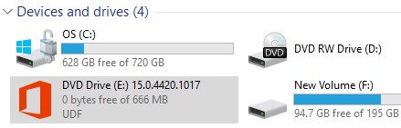

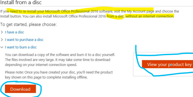

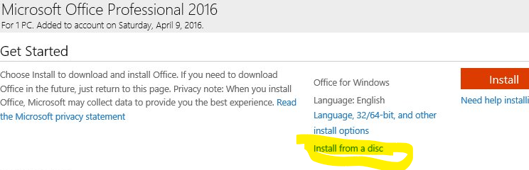

    On the office.com/myaccount, showing the office 2016 and the INSTALL BUTTON, there’s a link which says install from a disc*>*I WANT TO BURN A DISC > download (which would download the office IMG file..
    Copied Office IMG file on a flash/thumb drive. Back to the desktop, mounted the image file and install office (just like how you install office 2010, however wondered why on the installation process it never asked for a Product Key.

    Here’s the Good News though, I noticed that whenI VIEWED MY PRODUCT KEY from my account, it gave me 25 set of characters which is different with the one I have on the card… Tried using that and guess what, it says INSTALL then gave me option to activate office online or activate using Phone System….
    OH HEY!!! I INSTALLED office 2016 using Disc - in this case Virtual Disc and ACTIVATED it using a product key without needing to sign in or connect the installed office apps to Microsoft Account…  I need not go back to signing in with Microsoft Account to reinstall or activate the office. I have the office image and has printed the Activation Key……

    You then setup Office on the first computer using the company email address and password.  This creates an Office Account which can be accessed at: https://www.office.com/Myaccount
