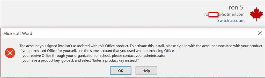

    I wish I had seen these instructions just a few hours ago when I was trying to do a local install of Office 2016.  My install had a couple of rude surprises for me.
    First I got this message, when it was blatantly wrong since Word clearly indicated that it was signed in, and when I checked File menu > Account command it showed it was activated :
    The second surprise came the next time I logged in to Windows.  My former, carefully crafted, Windows local account had been converted into an account tied into the same email account. Which is something I most emphatically did not want!
