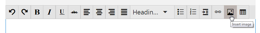

    You need to use the Insert image facility
    2017-01-13T16:23:27+00:00
    Well, I learned something with this point.  I can not paste an image.
    2017-01-13T16:22:28+00:00
