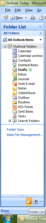

    0  Introduction
    Before starting, I need to point out one thing.  All the “folders” you see when looking around inside Outlook [such as Outlook folders, Inbox, Calendar] are just objects within the Outlook.pst file.  It’s a handy way for Outlook to display them.  They are not the same as folders you see within Windows explorer such as C:\Users\Earle\Documents.  I think there has been some confusion between the two before in this question so, just to be on the safe side, I’ll refer to “Outlook folders” [if I’m referring to one of the folders within Outlook] or “folders” [if I mean something in Windows explorer].
