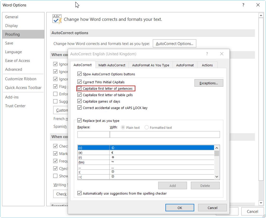

    It was pressing the Enter key at the end of the previous line that was being suggested.  If that was done, and the word that starts with i is the first word on the new line, then Word will treat it as the beginning of a new paragraph\sentence and if, under File>Options>Proofing>AutoCorrect Options>AutoCorrect, you have a check mark in the box for Capitalize first letter of sentences, that is what will be done with the I.
    That should not however happen if you are typing
    I was walking In the park, where I met my friend John Inside the café
    all on one line.  Is that really happening?

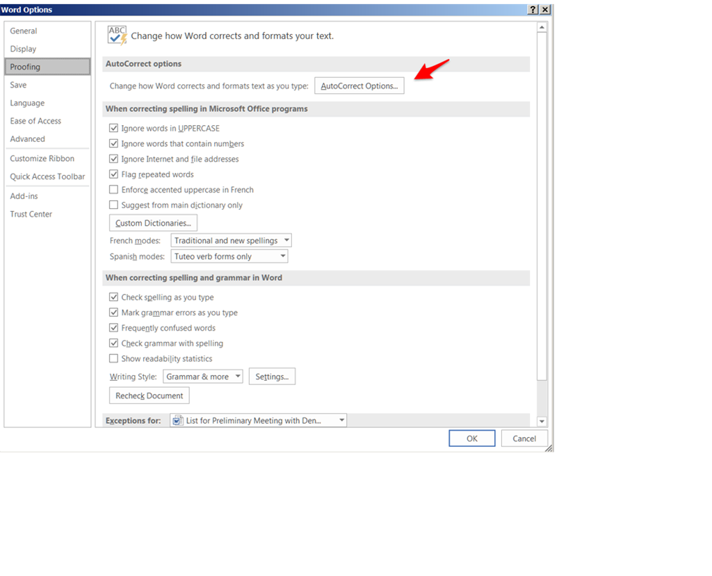

    Go to File, then Options (at the bottom) then pick Proofing on the left.
    See the screenshots below...Good luck!
