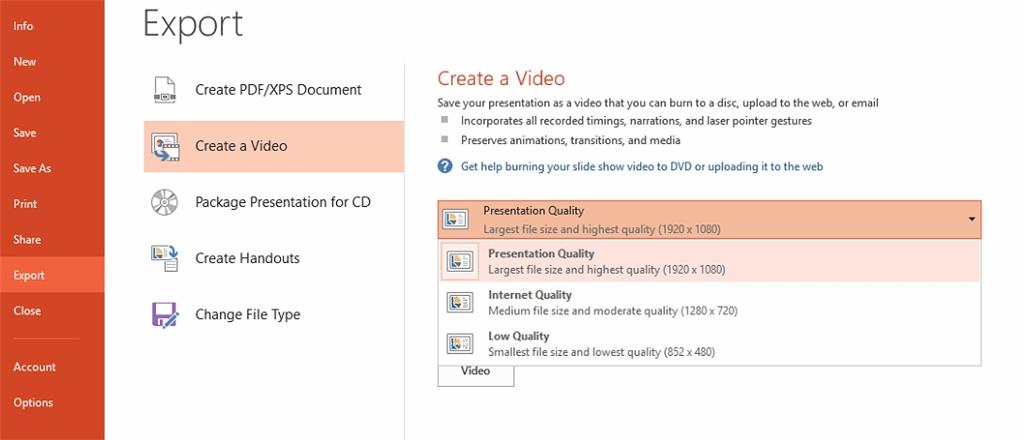

For years I have been using Microsoft PowerPoint as a powerful and professional presentation and animation software.
It seems to me, that its capabilities are widely underestimated, to say the least. Perhaps even by its own developers.
I'd like to know where I can find advanced video export settings in PowerPoint 2013.
Currently, the possibilities are quite limited, with an export resolution of 1280x720 being the maximum; the framerate leaves much to be desired as well.
Is there a free, convenient way of producing an HD quality video (including all the animations) without quality loss, using any Microsoft Office program?
Thank you for your support.
