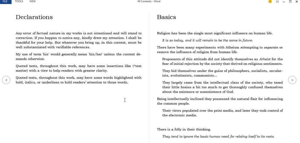

"Read Mode" in Word 2013 does not look as the "Take a Tour" document says - wonder why so?
2014-06-02T05:36:46+00:00
  • This question is based on Take a Tour document of Word 2013.
  • It says, as you see in the image below, that I can view a Word document in Read Mode where as the icon shows, the document will appear in book fold

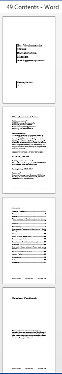

  • But then, as I click on Read Mode Icon, the following is what I get, NOT in book fold view as the icon shows
  • Wonder, why it is so, or what have I done wrong?

    • The following screenshot (view >> read mode >> view >> layout >> paper layout) is displayed in 20% zoom out state -
    • Whereas, the following screenshot (view >> read mode >> view >> layout >> column layout) was displayed in 100% (no zoom out, no zoom in) state -

    When Online Repair of Office 2013 did not help, I tried in "Read Mode" View | Layout | Column Layoutand I got the following at 100% screen (1360 x 768).
    In Word 2007 + Windows 7, I used to get a neat book like view and it never occupied the whole screen at 100% --
