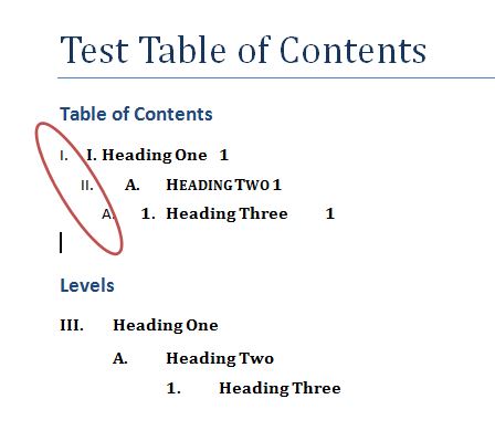

  3. Suzanne S Barnhill 279.4K Reputation points MVP Volunteer Moderator
    2014-05-08T23:17:34+00:00
    That tab stop is set by default; that's the problem here: the tab character is going to that tab stop because there is not one earlier in the paragraph.
    2014-05-08T22:30:28+00:00
    Thank you for trying to help me. I followed your suggestions and then tried to insert a TOC. The tab leaders disappeared, even though they were checked. The format for Heading Two changed to small caps. Also, a second tier of snuck in.  What could be going on?
