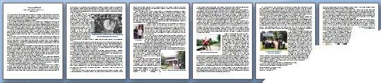

    2014-03-20T19:32:43+00:00
    This wasn't the easiest that I've run into. An 18.9Mb word/Document.xml file makes for slow going in a text editor. Typically, the bloated size was simply because the author didn't scale down numerous 8Mb - 2832 × 2132 pixel images.
    With only one keystroke operation possible every 30-45 seconds (text editors are not built for >10Mb files), I simply snipped out the offending section rather than attempt to repair it. You can find the actual raw Xml below. This was removed from the area immediately preceding the phrase "boat on the rio coco" on page 10 of 39. The phrase itself appears to be within a malformed text box or some-such.
    The repaired DOCX is loaded to my OneDrive here for you to download.
    Heart.and.Mind.Bio.edit.GTM (Jeeped).docx
    If you are looking to recreate the paragraph I snipped out, this was the full XML I removed. There isn't a lot of actual content in that.
    <w:p w:rsidR="005C2F3A" w:rsidRDefault="002F42C5" w:rsidP="00271C86"><w:pPr><w:jc w:val="both"/><w:rPr><w:sz w:val="24"/><w:szCs w:val="24"/></w:rPr></w:pPr><w:r><w:rPr><w:noProof/></w:rPr><w:lastRenderedPageBreak/><mc:AlternateContent><mc:Choice Requires="wpg"><w:drawing><wp:anchor distT="0" distB="0" distL="114300" distR="114300" simplePos="0" relativeHeight="251715584" behindDoc="0" locked="0" layoutInCell="1" allowOverlap="1"><wp:simplePos x="0" y="0"/><wp:positionH relativeFrom="column"><wp:posOffset>47625</wp:posOffset></wp:positionH><wp:positionV relativeFrom="paragraph"><wp:posOffset>286385</wp:posOffset></wp:positionV><wp:extent cx="6819900" cy="2486025"/><wp:effectExtent l="0" t="0" r="0" b="9525"/><wp:wrapSquare wrapText="bothSides"/><wp:docPr id="11294" name="Group 11294"/><wp:cNvGraphicFramePr/><a:graphic xmlns:a="http://schemas.openxmlformats.org/drawingml/2006/main"><a:graphicData uri="http://schemas.microsoft.com/office/word/2010/wordprocessingGroup"><wpg:wgp><wpg:cNvGrpSpPr/><wpg:grpSpPr><a:xfrm><a:off x="0" y="0"/><a:ext cx="6819900" cy="2486025"/><a:chOff x="0" y="0"/><a:chExt cx="6819900" cy="2486025"/></a:xfrm></wpg:grpSpPr><pic:pic xmlns:pic="http://schemas.openxmlformats.org/drawingml/2006/picture"><pic:nvPicPr><pic:cNvPr id="47" name="Picture 47"/><pic:cNvPicPr><a:picLocks noChangeAspect="1"/></pic:cNvPicPr></pic:nvPicPr><pic:blipFill><a:blip r:embed="rId38"><a:extLst><a:ext uri="{28A0092B-C50C-407E-A947-70E740481C1C}"><a14:useLocalDpi xmlns:a14="http://schemas.microsoft.com/office/drawing/2010/main" val="0"/></a:ext></a:extLst></a:blip><a:stretch><a:fillRect/></a:stretch></pic:blipFill><pic:spPr><a:xfrm><a:off x="0" y="0"/><a:ext cx="1866900" cy="2486025"/></a:xfrm><a:prstGeom prst="rect"><a:avLst/></a:prstGeom></pic:spPr></pic:pic><pic:pic xmlns:pic="http://schemas.openxmlformats.org/drawingml/2006/picture"><pic:nvPicPr><pic:cNvPr id="48" name="Picture 48"/><pic:cNvPicPr><a:picLocks noChangeAspect="1"/></pic:cNvPicPr></pic:nvPicPr><pic:blipFill><a:blip r:embed="rId39"><a:extLst><a:ext uri="{28A0092B-C50C-407E-A947-70E740481C1C}"><a14:useLocalDpi xmlns:a14="http://schemas.microsoft.com/office/drawing/2010/main" val="0"/></a:ext></a:extLst></a:blip><a:stretch><a:fillRect/></a:stretch></pic:blipFill><pic:spPr><a:xfrm><a:off x="4352925" y="47625"/><a:ext cx="2466975" cy="1685925"/></a:xfrm><a:prstGeom prst="rect"><a:avLst/></a:prstGeom></pic:spPr></pic:pic></wpg:wgp></a:graphicData></a:graphic></wp:anchor></w:drawing></mc:Choice><mc:Fallback><w:pict/><w:r><w:drawing><wp:anchor distT="0" distB="0" distL="114300" distR="114300" simplePos="0" relativeHeight="251714560" behindDoc="0" locked="0" layoutInCell="1" allowOverlap="1" wp14:anchorId="52444DE0" wp14:editId="216C663D"><wp:simplePos x="0" y="0"/><wp:positionH relativeFrom="column"><wp:posOffset>1901825</wp:posOffset></wp:positionH><wp:positionV relativeFrom="paragraph"><wp:posOffset>334010</wp:posOffset></wp:positionV><wp:extent cx="2498090" cy="1685925"/><wp:effectExtent l="0" t="0" r="0" b="9525"/><wp:wrapSquare wrapText="bothSides"/><wp:docPr id="49" name="Picture 49"/><wp:cNvGraphicFramePr><a:graphicFrameLocks xmlns:a="http://schemas.openxmlformats.org/drawingml/2006/main" noChangeAspect="1"/></wp:cNvGraphicFramePr><a:graphic xmlns:a="http://schemas.openxmlformats.org/drawingml/2006/main"><a:graphicData uri="http://schemas.openxmlformats.org/drawingml/2006/picture"><pic:pic xmlns:pic="http://schemas.openxmlformats.org/drawingml/2006/picture"><pic:nvPicPr><pic:cNvPr id="0" name=""/><pic:cNvPicPr/></pic:nvPicPr><pic:blipFill><a:blip r:embed="rId40"><a:extLst><a:ext uri="{28A0092B-C50C-407E-A947-70E740481C1C}"><a14:useLocalDpi xmlns:a14="http://schemas.microsoft.com/office/drawing/2010/main" val="0"/></a:ext></a:extLst></a:blip><a:stretch><a:fillRect/></a:stretch></pic:blipFill><pic:spPr><a:xfrm><a:off x="0" y="0"/><a:ext cx="2498090" cy="1685925"/></a:xfrm><a:prstGeom prst="rect"><a:avLst/></a:prstGeom></pic:spPr></pic:pic></a:graphicData></a:graphic><wp14:sizeRelH relativeFrom="page"><wp14:pctWidth>0</wp14:pctWidth></wp14:sizeRelH><wp14:sizeRelV relativeFrom="page"><wp14:pctHeight>0</wp14:pctHeight></wp14:sizeRelV></wp:anchor></w:drawing></w:r></w:p>
    HTHs.
