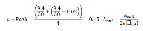

    The text is between <m:t> </m:t> tags so from the first part of the XML in one of your previous posts,
    <m:t>R</m:t>
    </m:r>
    </m:oMath>
    <m:oMath>
    <m:r>
    <w:rPr>
    <w:rFonts w:ascii="Cambria Math" w:hAnsi="Cambria Math"/>
    </w:rPr>
    <m:t>coil</m:t>
    we can get
    Rcoil
    This was how the equation appeared after removal of the problem xml code
    and the text that I retrieved from the corrupt xml code consisted of
    coil
    804
    m
    2
    0.15m
    853m
    Looks like I omitted to include the Unit (m) on the radius of the coil (0.15m) which was in the text for the second equation, but appears to have been omitted by the author for the first equation.
    That would make the correct equations:
    now with the semi-colon separator re-inserted.
    Note, I did check that 853m was the correct result.  However, I cannot see in preceding text in the paper any calculation that comes up with the area of 804m².  If Annette is still paying attention, she might look into that.
