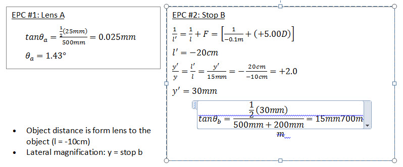

    Note that there is a bit of slightly garbled text at the beginning of the document that is formatted as hidden

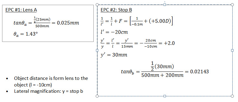

    The actual problem with the document was the equation selected below in EPC #2: Stop B
    I have replaced the 15mm700mm with the result 0.02143.
    Note also that as a Tangent is a ratio, it does not have units.  Therefore, the result of EPC #1: Lens A formula is not really correct.
