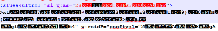

    I'm afraid your document suffered a catastrophic corruption and only a few pages were able to be recovered. Corruptions of this magnitude are typical of working to/from a portable memory device like a thumb drive or SD card.
    As you can see, your data was scrambled by the inability to flush the buffers your memory device was using before it was disconnected.
    I did manage to recover the first four pages, such as they were. The repaired portion of your DOCX is available from my DropBox at:
      Dissertation (Jeeped).docx
    I'm sorry but that is the best I can come up with.
