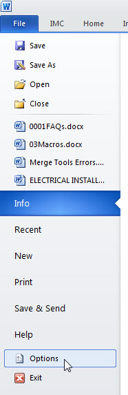

Sounds like you may have a Bluetooth Add-in that is causing the problem.  Click on the File menu, then Options and then on Add-Ins and then click on the Go button alongside Manage Add-ins and if there is a Bluetooth Add-in, disable it.

    Here's a picture of it
