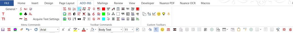

    It might interest/amuse you to see my 365/2013 QAT etc. Luckily Ron de Bruin worked out a way to bring 2003 macros and buttons across to 2010. I have around 10 of them on my QAT - all I can fit in. Many of the rest are in ADD-INS. How MS could take a perfectly good program and f__k it up never ceases to amaze me. Fingers crossed that they can take their blinkers off long enough to see this AND FIX IT.
