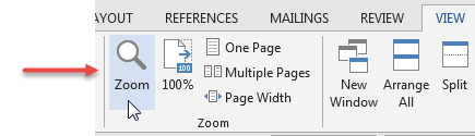

Use the Zoom slider in the bottom right corner
or the Zoom button on the View ribbon
