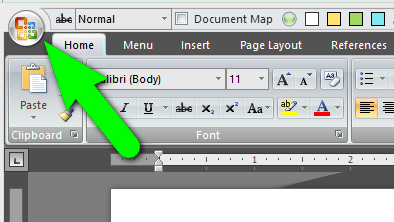

    Is this what you see:
    Word 2007 ribbon with the "Pizza Button" highlighted

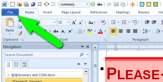

    Or do you see something like this:
    Word 2010 Ribbon with the File Tab highlighted.
    Assuming you really have Word 2007 Here is what you are looking for to get to the Options dialog

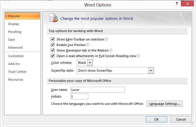

    And here is the Word 2007 Options Dialog
    From here you have click on the appropriate option in the left column then search for the specific option. It can be a challenge even for someone with full sight to find the options buried in the long list.

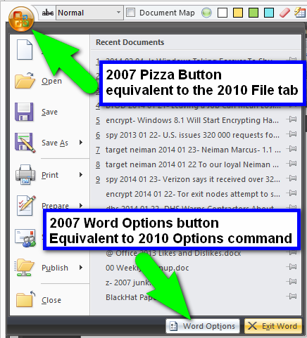

  3. Doug Robbins - MVP - Office Apps and Services 323.6K Reputation points MVP Volunteer Moderator
    2014-02-11T22:34:43+00:00
    The four square boxes logo (sometimes referred to as the "Pizza Button" or the "Office Button") indicates that you are using Office 2007 and in that case, when you click that button, in the bottom border of the dialog that appears will be an item "Word Options".  If you click on "Word Options" that is the same as clicking the File tab of the ribbon in Word 2010 and then on Options.
