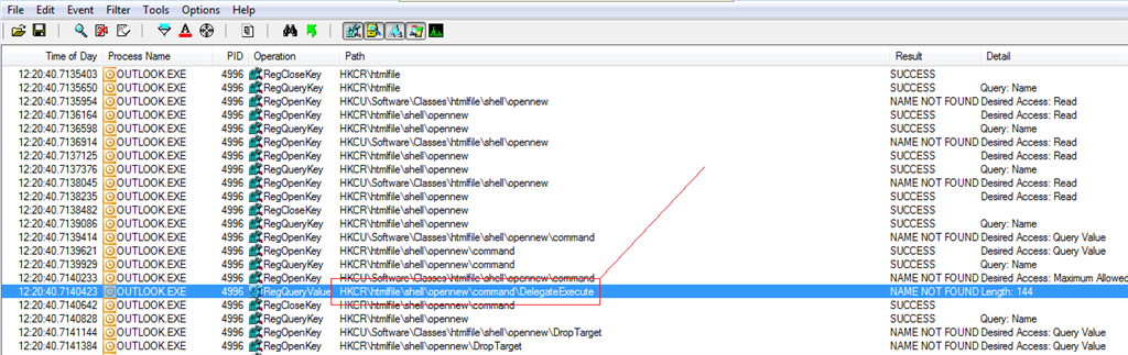

    So, I didn't quite give up and tried one more thing...
    With Internet Explorer set as the default browser, I ran procmon while trying to click on a link in Outlook noticed Outlook.exe was trying to open but was not finding CLSID {17FE9752-0B5A-4665-84CD-569794602F5C}
    I searched the registry for that GUID and the only places I was seeing that GUID appear was in a "DelegateExecute" string under all of the "...\shell\open\command" keys with default pointing to "C:\Program Files (x86)\Internet Explorer\iexplore.exe" -nohome
    So I went through and manually deleted all occurances of that DelegateExecute string that had the value {17FE9752-0B5A-4665-84CD-569794602F5C} and finally it started working, yay!
    Now I finally got Internet Explorer working as my default browser.

    In dwz post on Jan 5, 2012 listed a registry script with the paths of the "..shell\open\command" keys where it stores information about which browser and how to start that browser when you click on a URL.  For some reason when I switch to Internet Explorer as my default browser it puts in those "DelegateExecute" strings with GUID value "17FE9752-0B5A-4665-84CD-569794602F5C" under those registry keys, but there is no COM library or executable registred under that GUID causing the class not registered error.  It looks like when the "DelegateExecute" string exists it will try and start the browser using a delegate COM library or executable instead of using a shell command.  So I believe when I removed those "DelegateExecute" strings using regedit.exe it stopped trying to use the delegate and instead use the shell command to start Internet Explorer.

    Hi, gkriggs
    you are right about those GUID, I run process monitor as your suggestion and saw what you explain in this post.
    seem like , outlook try to use that DelegateExecute registry everytime user click on URL in e-mail.
