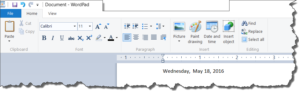

    Yes, Word is a BIG (bloated) program with lots of quirks. I do not know that anyone understands it completely, including those who designed it. Frankly, WordPad, which is free with every version of Windows has far fewer quirks and is much easier to learn. It may be just what you want for taking notes. I do not believe WordPad has fields.
