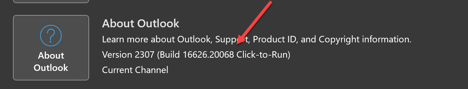

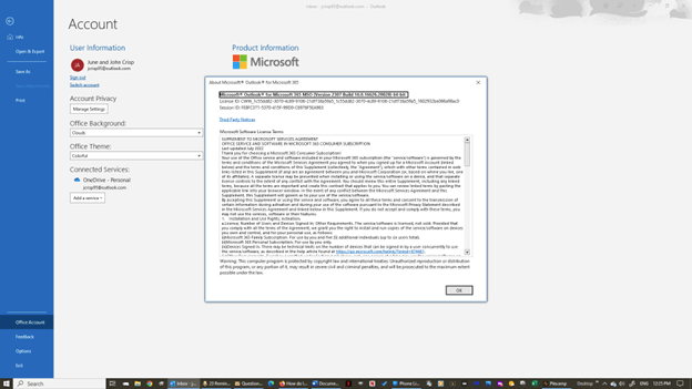

    #1. My
    Account Information/Account Settings widow looks different than the screenshot that you sent to me. I do not know how to get to "server settings".
    #2. The link you provided seems to provide information as to how to add Yahoo to my Outlook desktop. I do not want to add Yahoo to my Outlook desktop.

    #1 - The reason your screenshot is different is because you did not selsct the Verizon account as the first step
