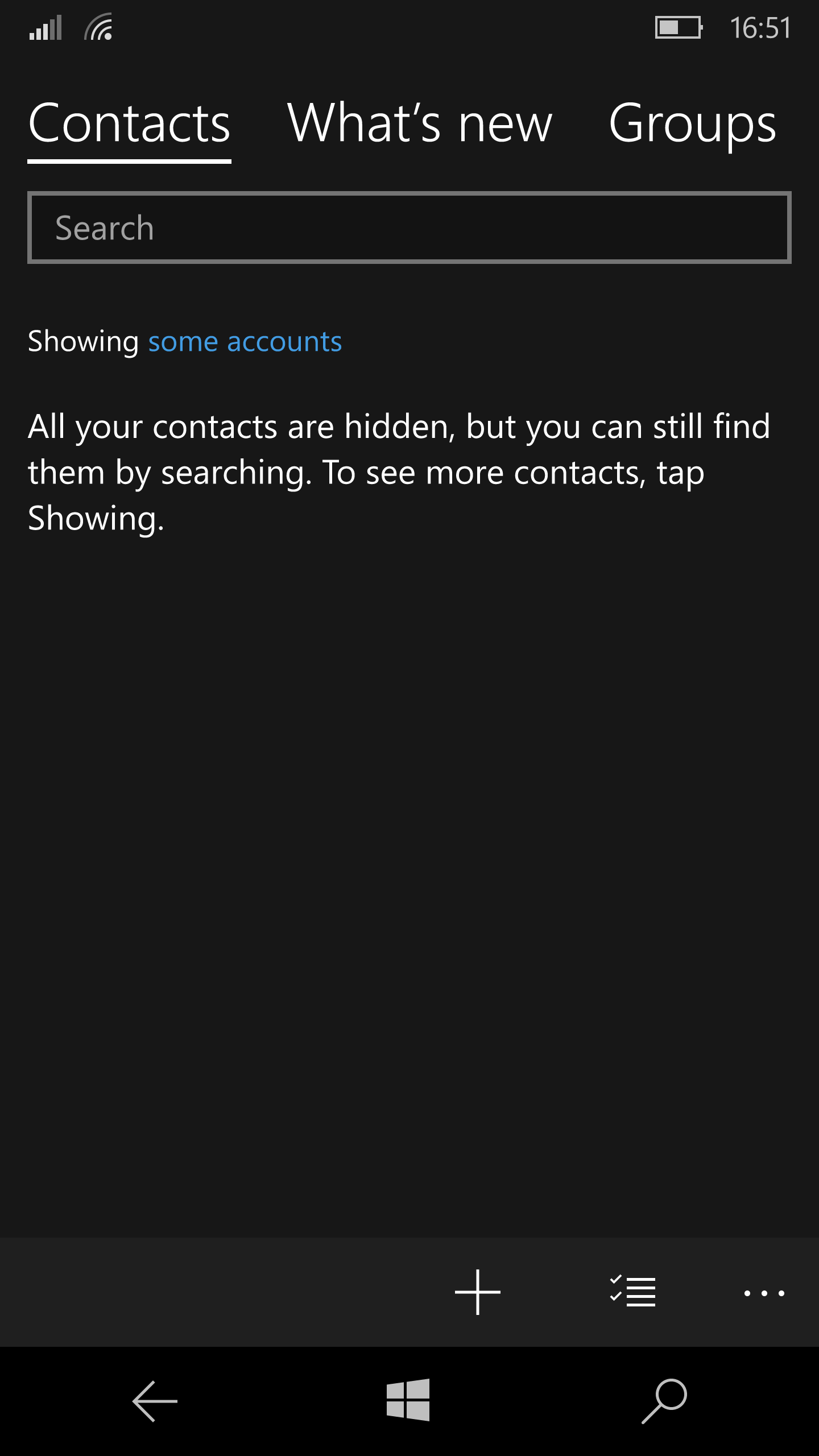

I have checked that I have latest OS version 10.0.15254.603, not updates for outlook app, removed and added account (that deletes all my contacts so phone is now UNUSABLE!!!!!), changed password, tried server outlook.office265.com instead m.hotmail.com. Nothing worked.

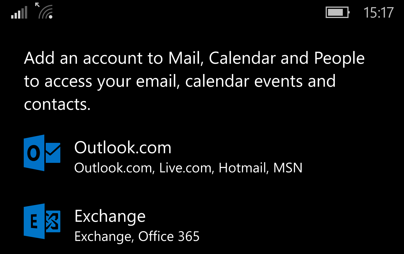

  1. On the phone, go to Settings > Accounts > Email & app accounts > Add an account > Advanced setup (at the bottom of the list) > Exchange ActiveSync

  6. Tap "Add an account"
  7. Select the "Exchange" option

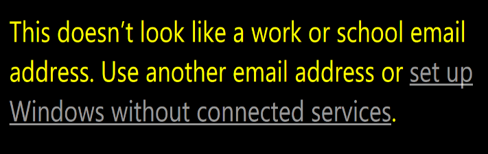

  9. Acknowledge the prompt that that is not a work account, etc.
