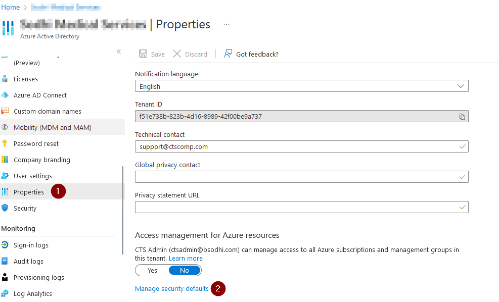

    Hi Joe,
    This happened off lately.
    In order to check for security defaults. You can go to Azure Portal.
    From there Azure Active Directory --> Properties as shown
    From here you would be able to see if it is enabled or not.
    If enabled turn it off.

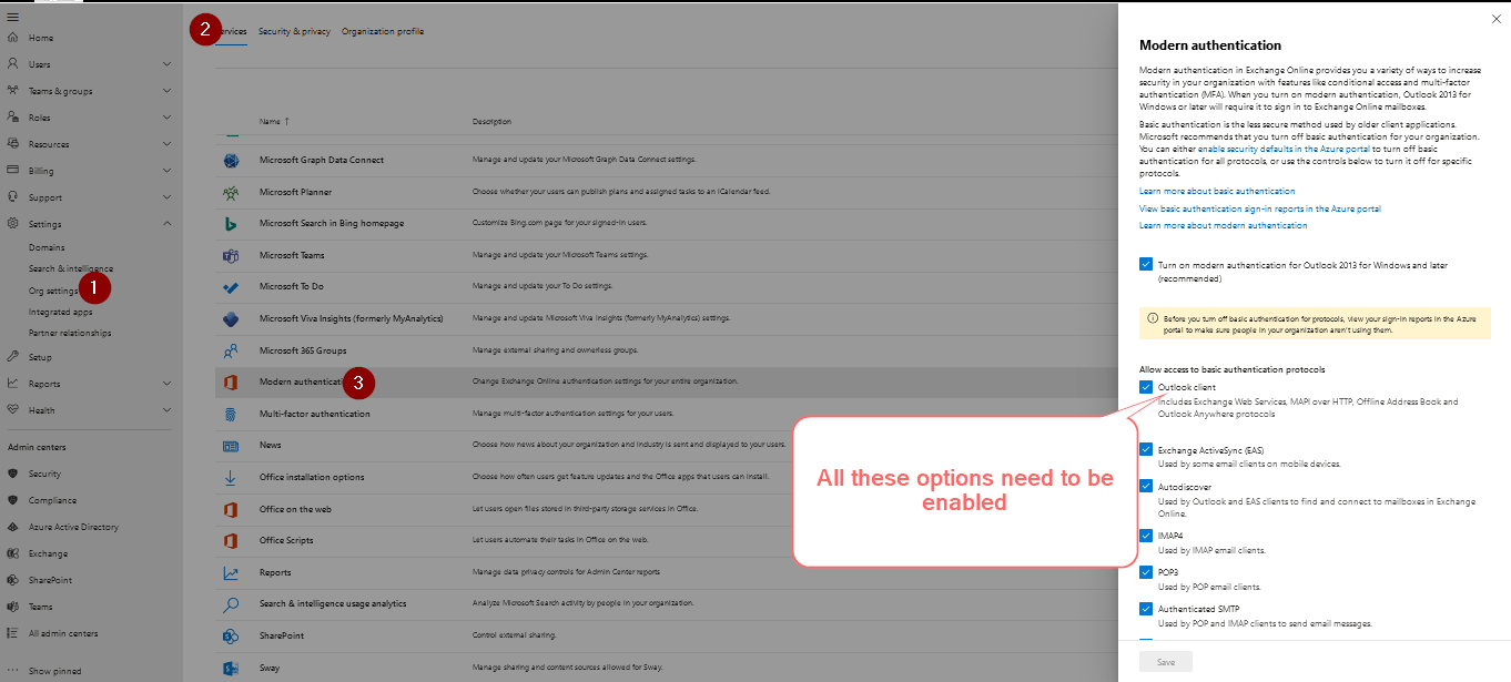

    Secondly if you have Azure Conditional Access enabled for MFA for all users that could be also a issue since Azure Conditional Access blocks access to legacy apps which support SMTP authentication.
    Also in the Admin Centre check for the snippet below
    See if this helps.
    2022-12-28T21:46:16+00:00
    Hi Ankur,
    Thanks for your post with pictures, I have checked it and our settings are exactly as posted. I am 100% positve that some sort of bug is currently causing this issue.
