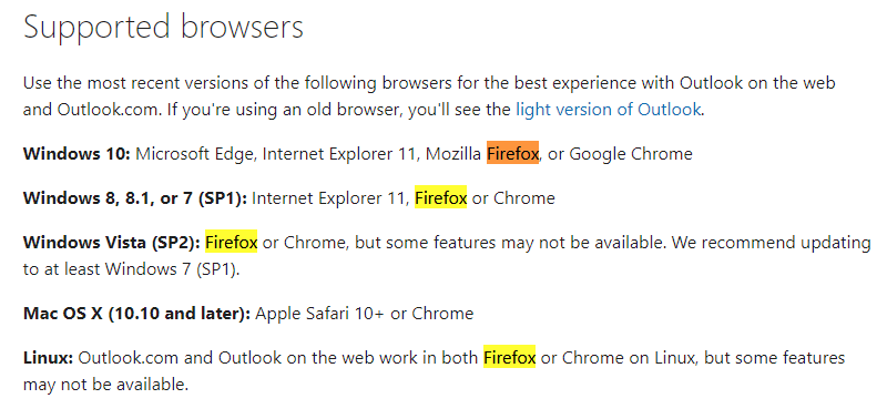

An IT tech at my employer sent Microsoft a bug report on this issue. An MS tech contacted me via e-mail for details. After sending them the details, the MS tech replied that they are not going to investigate this problem because it affects Firefox but not Edge. This is contrary to the fact that according to this page Firefox should be supported. So it looks like our only recourse is to use a different browser and gripe.

    Based on my research, Firefox is a supported browser for Outlook on the Web (outlook.office.com). You may check if the browser has been updated to the most recent version. See Supported browsers for Outlook on the web and Outlook.com (microsoft.com).
