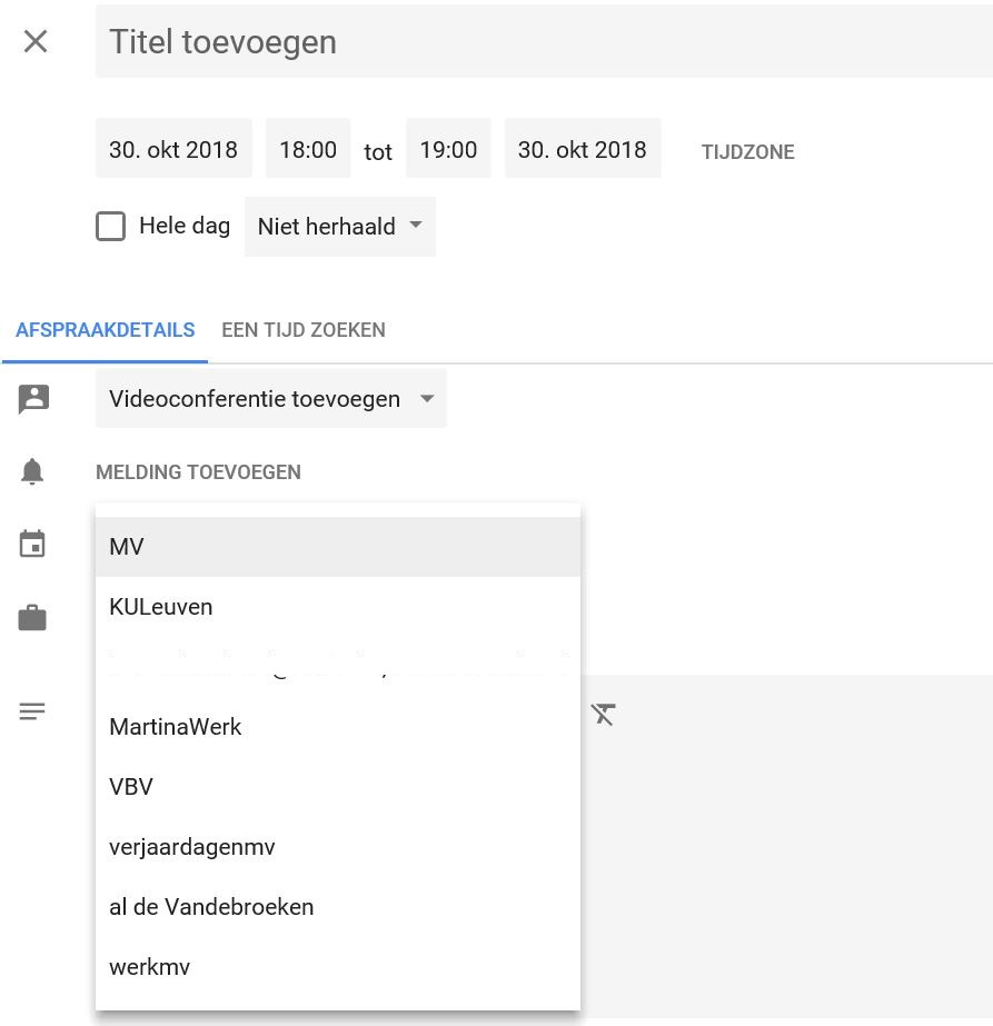

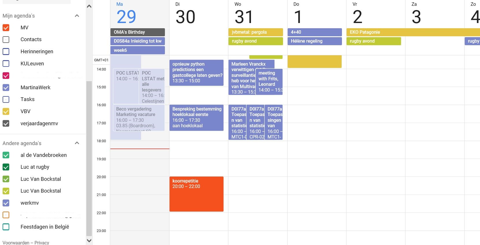

    Jennifer, I am not able to open outlook in safe mode with the instructions that I have found on Toledo because my computer says that he cannot find the outlook.exe file and I cannot find it either. Where should it be saved?
    I cannot remove the weather categories from my google calendar because I have never seen or used them in that calendar either - see pictures below. (I only thought they came from google via OggSync but I have no proof of that either; it can as well be a bug in outlook)

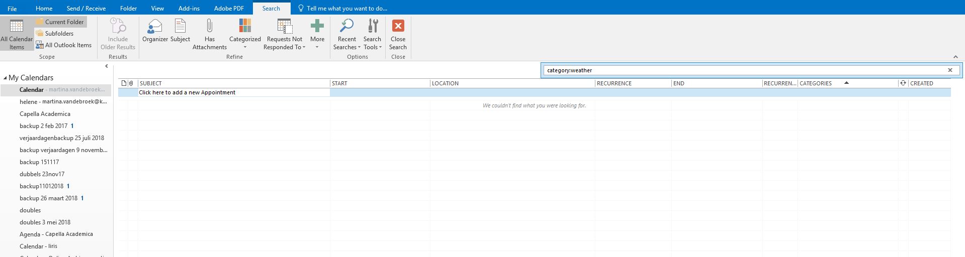

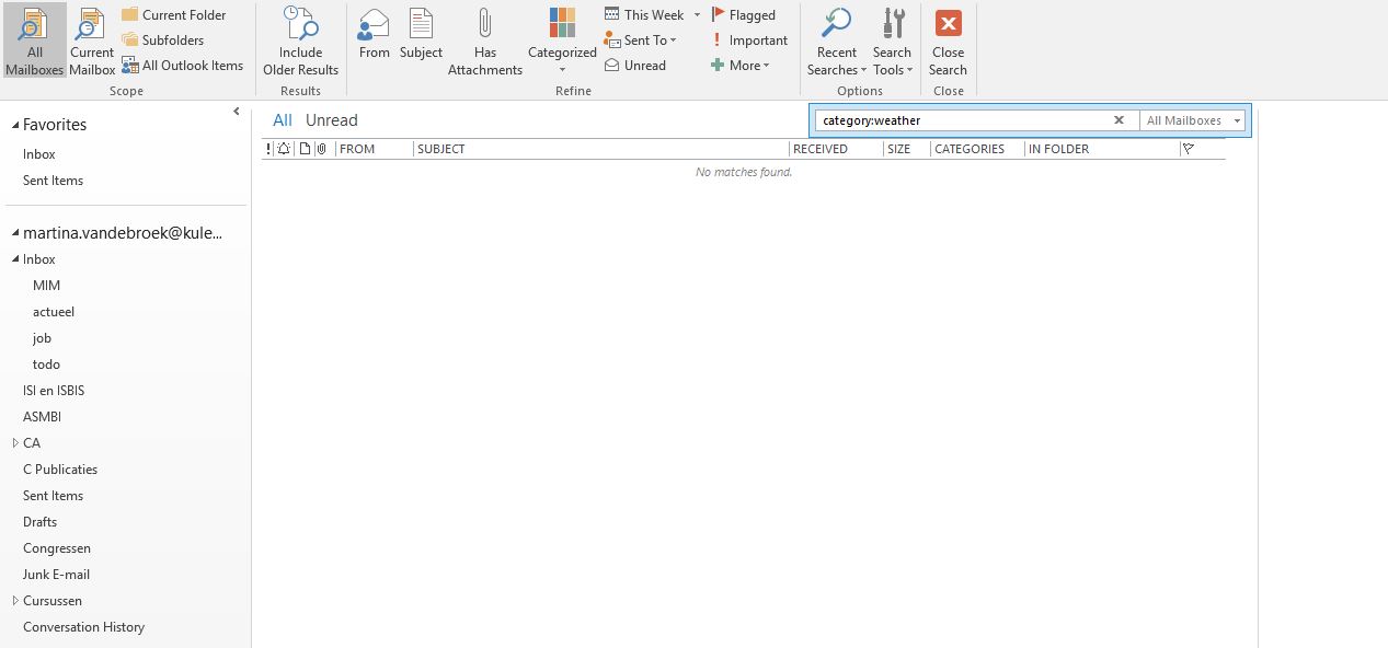

    2018-10-26T13:34:49+00:00
    I know how to search for categories in my mailbox and appointments and how to remove categories that are assigned. I do hope  that with the following screenshorts you will at last believe that I have to mails or appointments assigned to the weather categories...
