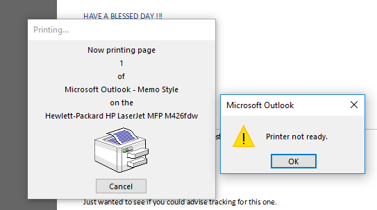

I have been with the support team multiple times and we still cannot figure out why I cannot print from my Outlook App.
We have tried resetting the print spooler, updating Outlook, updated any and all drivers on my computer, temp files seem to be fine with full permissions on my account. I am kind of at my wits end with this, the only way i can print is by emailing the documents to my printer, and that is such a waste of paper because i really only need to print to PDF most of the time, but it will not function.
My printer works with every other application, and it will print from outlook when open in a web browser.

    yes it does show my printer, and it will print intermittently.
    Meaning it will print some of my emails, but it seems like the ones i need to print wont. I cant seem to find any pattern as to why it will not print some but will others.
    Attached is the error message it gives me when it wont print, however my printer is on/ready and it will print everything else I try to print. Just not from outlook.
