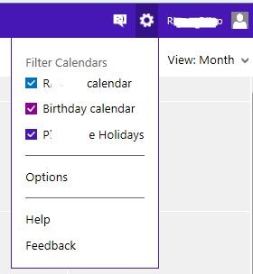

    Are you referring to your Outlook.com Calendar (https://calendar.live.com )? If that is the case, please check if all your calendars are ticked just like in the snippet below:
    Yes, it is the same calendar as indicated in your link.  In fact I opened the calendar using your link and repeated the test with fast foward and reverse of the months and all the 11 birthdays disappeared again.  I closed the tab for the link.  Went back and accessed your link again and low and behold, all 11 birthdays were there again.   Also, I have 3 calendars: "Bruce's Calendar", "Birthday Calendar" and "Canada Holidays" Calendar.  All three have the check marks as indicated in your snippet.  I un-checked the birthday calendar and then checked all the months for 2015.  All showed no birthdays.  I then did the forward and reverse month review from 2015-Jan 2018.  I reviewed 2015 and there were no birthdays.  I then re-set the checkmark for the birthday calendar and all 11 birthdays were displayed.
