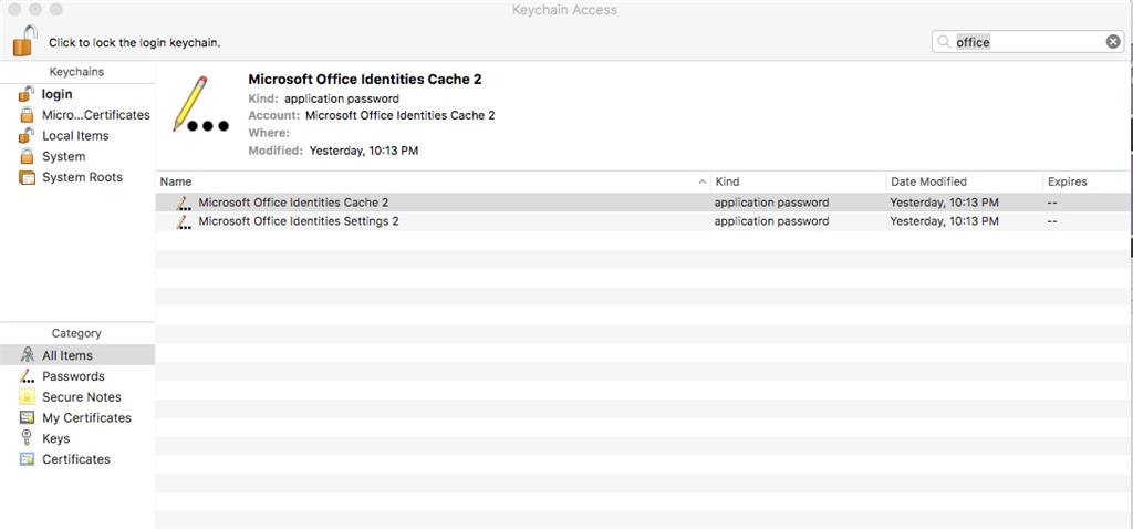

    Hey Sam! I only have 2 Office related credentials (shown below) and I've deleted them multiple times with no effect. I haven't done a uninstall/reinstall yet, but I suppose that's the only thing left to do on this problem.

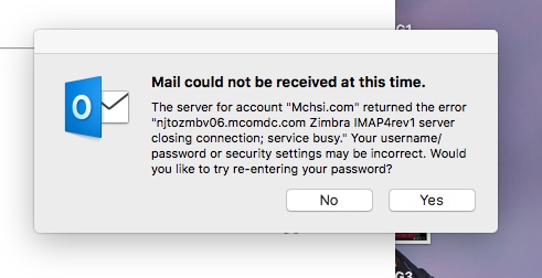

    Problem in a nutshell: I'm running Outlook 2016 for Mac (15.29/161209). The connection to the mail server (Mediacom) is wildly erractic. Connects for a minute and then disconnects for hours. Quitting and restarting Outlook sometimes helps and sometimes doesn't. When I restart I get a prompt to enter the password for my account. I enter it, check the box to remember in the Keychain, hit OK, and then the prompt returns with the same request. This happens 3 or 4 times in a row. When I open my Account details I see that the password box is empty.
    Just a moment ago the password prompt appeared, I put my password in and the following message appeared:
    This message appears all the time. Even though this message appeared, a few moments ago Outlook connected to the server and synced the folders. Right now things are connected but I don't know why.
