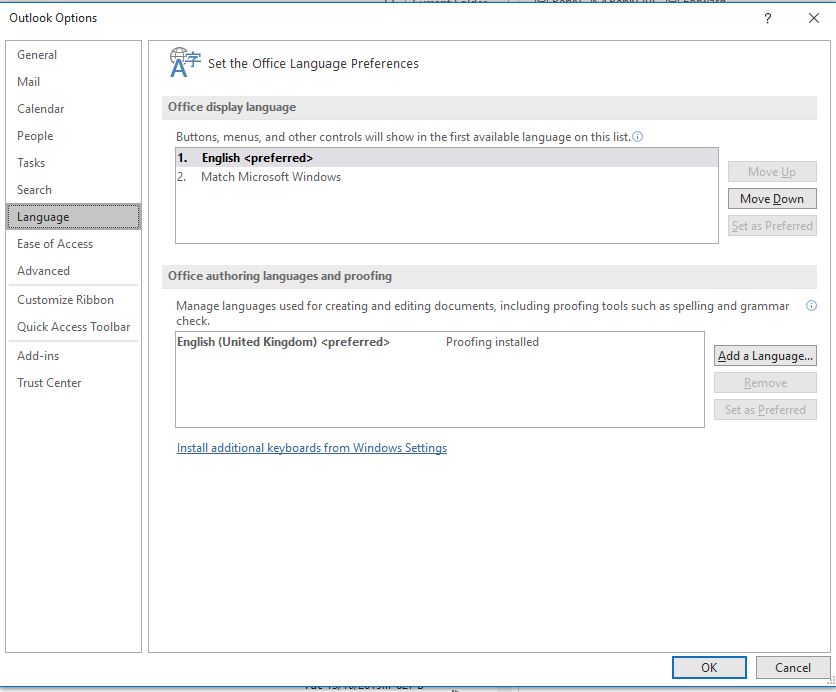

Hi All,
I had the same issue and fixed this by doing the following:
Open Outlook, click on File> Options> Language>
Under Office Display Language there were 2 options:
1. Match Microsoft Windows <preferred>
2. English
I moved these around so that they were displayed as follows:
1. English <preferred>
2. Match Microsoft Windows
After restarting Outlook the issue had resolved.
Hope this helps.
