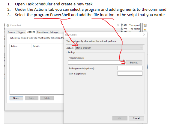

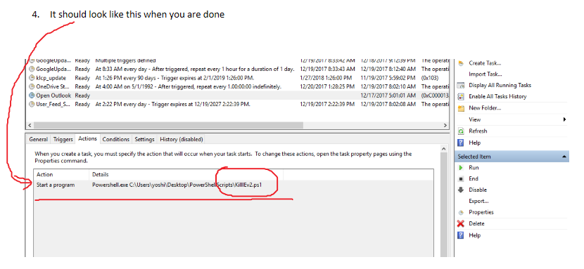

    Once you save the script then you have to create a Task Scheduler that will trigger when clicked.

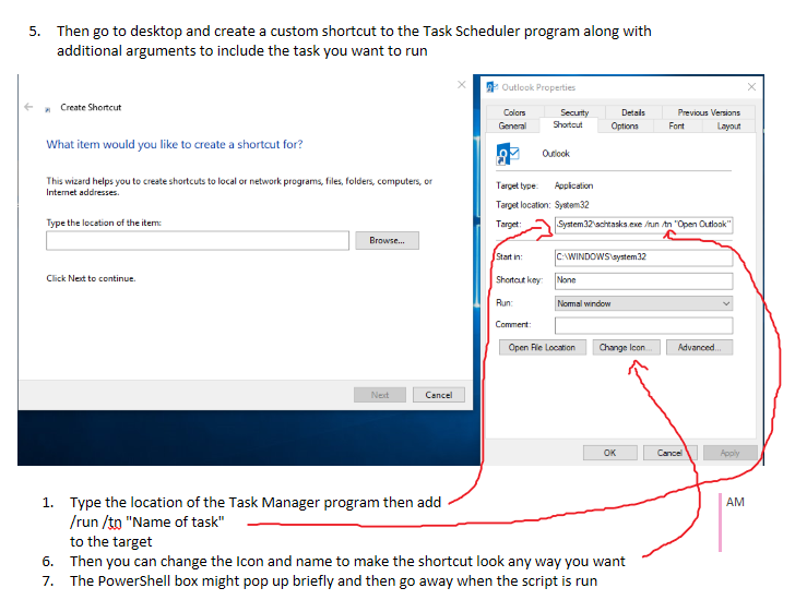

    Then when you are done, you have to make a custom shortcut that will run this task when clicked
    Afterwards you can change the icon for the shortcut to make it look like an Outlook icon so that no one that uses it realizes that it is not the orginal shortcut.
    This is messy but it gets the job done...
