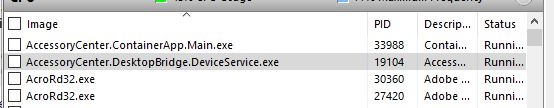

I am starting to look at this application : accessory center.desktop bridge.device service.exe
to see if this has something to do with this.

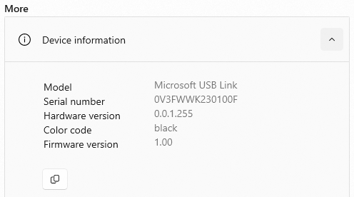

    What versions of the USB does everyone ELSE have? this is mine.
    and for the headset :
