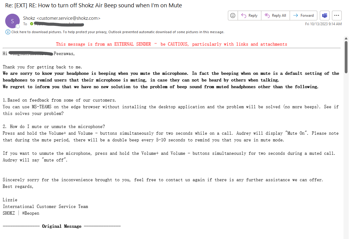

    I contacted with SHOKZ Customer Support and gave them feedback about this problem
    It's SHOKZ default setting and we need to work around it.... anyway I will buy new headphones and won't go back to Shokz... (For using with MS Team)

    Too bad the +- solution isn't working anymore. A work-around that works for me (for now...) is switching to the microphone of my laptop. My AfterShokz headset says "Mute Off" when I do so, and the annoying beep stops.
    During a Teams meeting go to "... More" and select "Settings / Device Settings" and then select a microphone that is not AfterShokz.
    Hope this helps.
