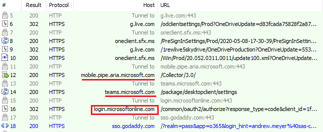

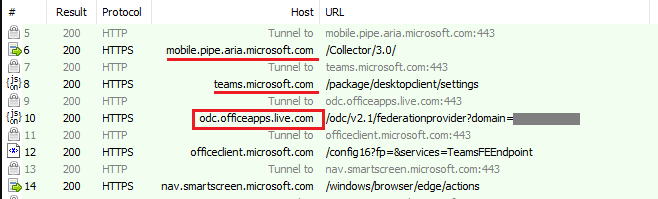

    2020-05-09T08:39:43+00:00
    Hi J.D. Jankowski,
    From the fiddler log screenshots, you can see they connected to different hosts. The failed one connected to odc.officeapps.live.com. From my research, this URL is dedicated for Microsoft personal accounts. While the successful one was redirected to the right Microsoft 365 login host login.microsoftonline.com.
    From my perspective, this issue could be related with the DNS records of the domain. Because the root cause is that the user credential is sent to the wrong host for authentication after Teams resolves the domain of the user account. To protect your privacy, I'd like to discuss this in private message.
