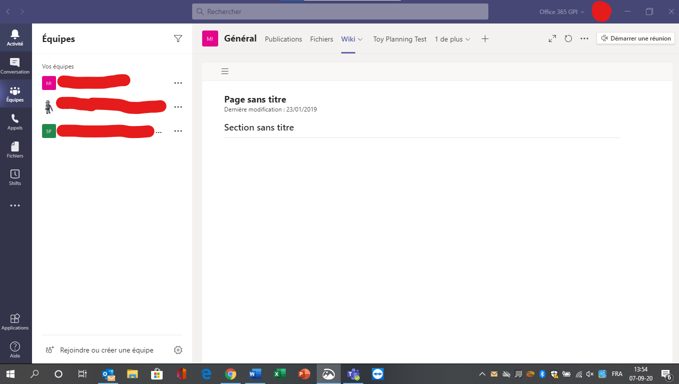

    Bonjour,
    Je n'ai pas la fonctionnalité "calendrier" sur mon teams. Serait-il possible de me dire ce que je dois faire afin de l'avoir et de pouvoir planifier des réunions via Teams ?
    D'avance je vous en remercie,
    Doyen Julie

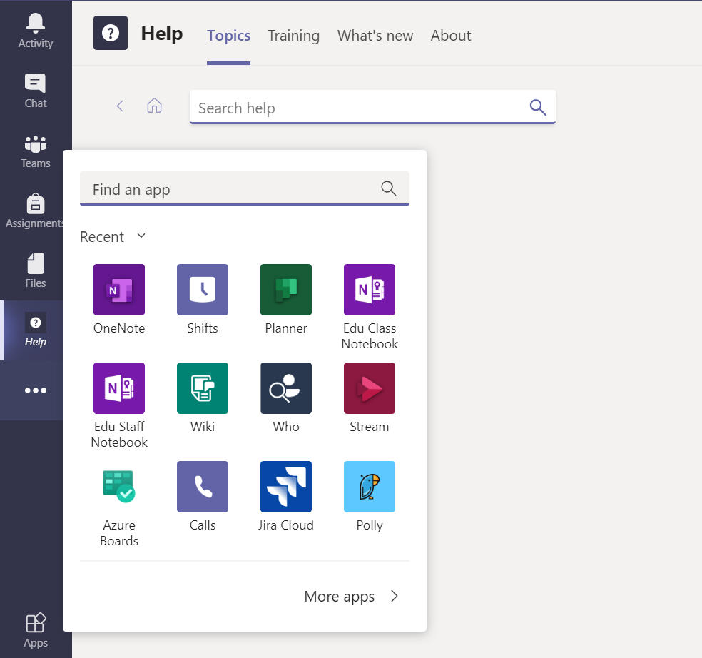

    Hello Seven,
    I have tried all the steps that you recommended but the calendar is still not showing in Teams app. I have attached a image of all my apps in Teams. Moreover, I have also tried to sign in my Outlook mail in a private window but the problem still persists.
    I have a student account in which I have signed in before my classes started compared to my classmates, who have Calendar in their Teams. Could this be the reason that I don't have Calendar in my Teams ?
    Regards,
    Meenal Samdhani
