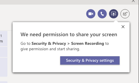

I updated to MacOS Catalina and now I cannot share my app screens. I can share my desktop, but that is all others can see.

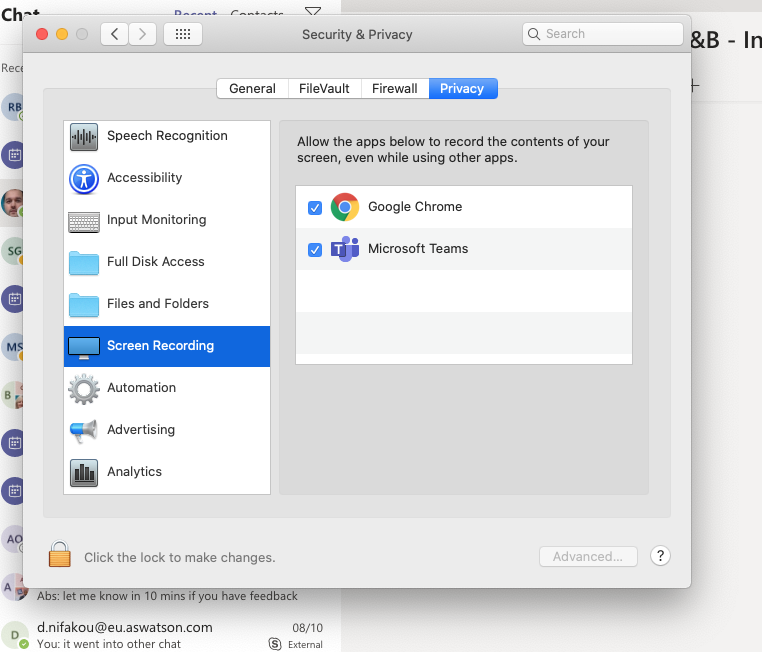

Found it.
System Preferences
Security & Privacy
Privacy
Screen Recording
My system had an entry (unchecked) for Microsoft teams. I think it asked me as I was launching but I blew by it. Not sure how you'd add it if it's not there. You just have to turn it on, and Teams screen sharing will work.
