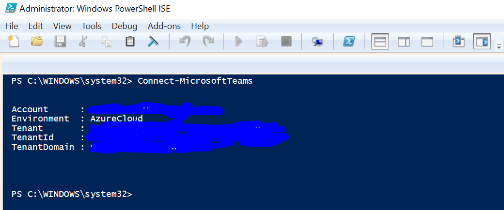

    2019-10-06T23:08:01+00:00
    yes it works when run powershell ISE as a administrator. Does that mean i need to use powershell ISE to connect team

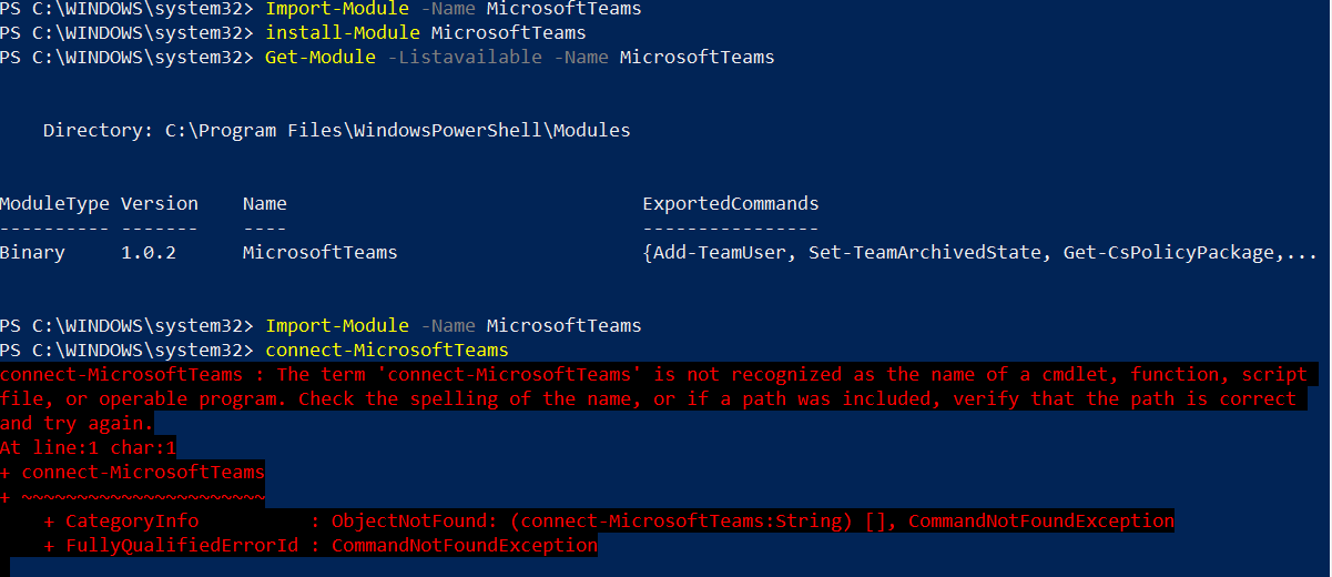

    2019-09-23T02:19:47+00:00
    Hello Ashka123,
    From the latest error message you provided, I can see the module was installed without any problems but the installed module wasn’t imported to the session when you use any commands. Please run the following command Import-Module -Name MicrosoftTeams to import the Microsoft Teams module or Get-Module -ListAvailable | Import-Module to import all the available modules.
