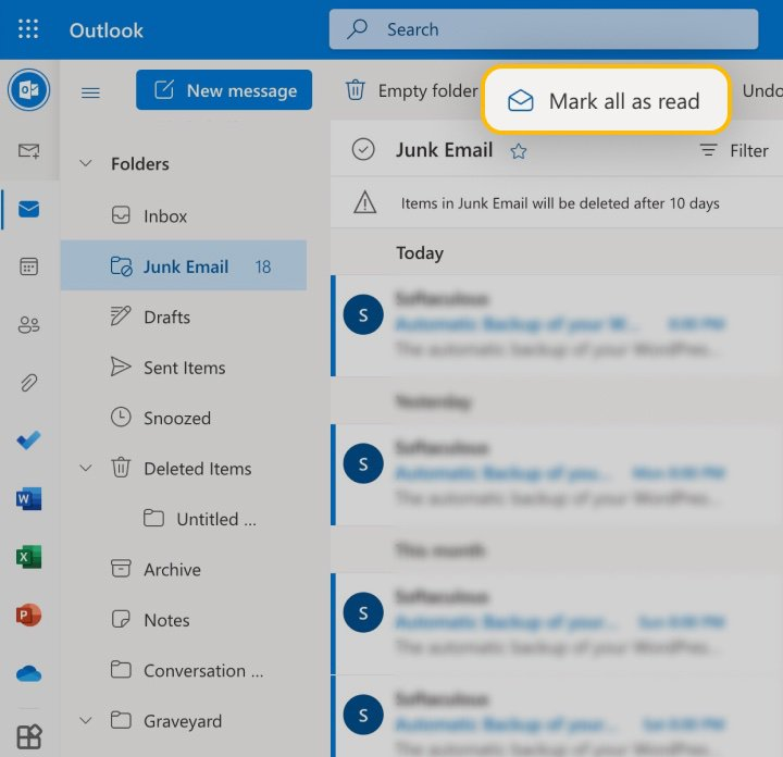

How to Mark All Emails as Read in Outlook | Clean Email
