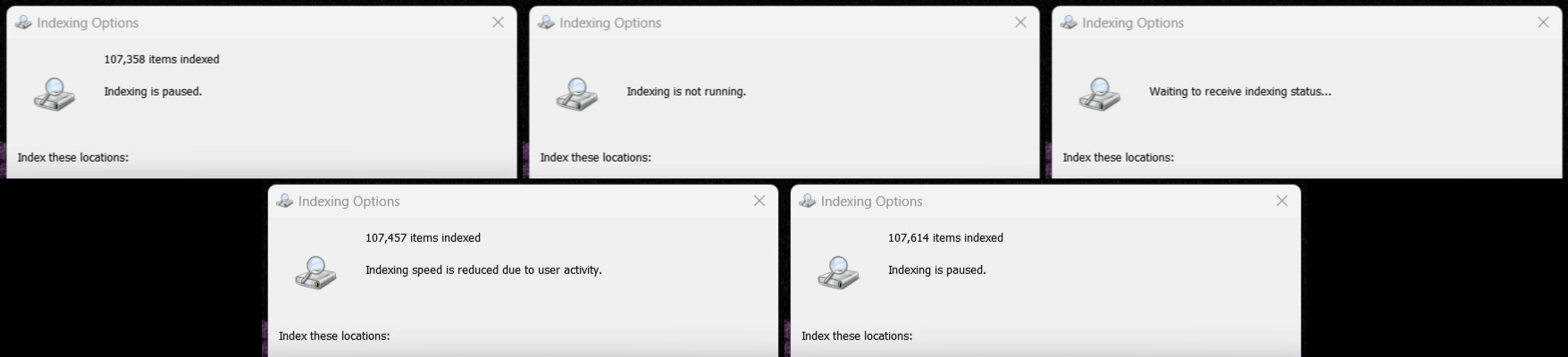

    I have the same problem as well, tried this method and I get in the order shown in the picture. I saw someone mentioned going into policy editor to edit so i'll try that and see...
