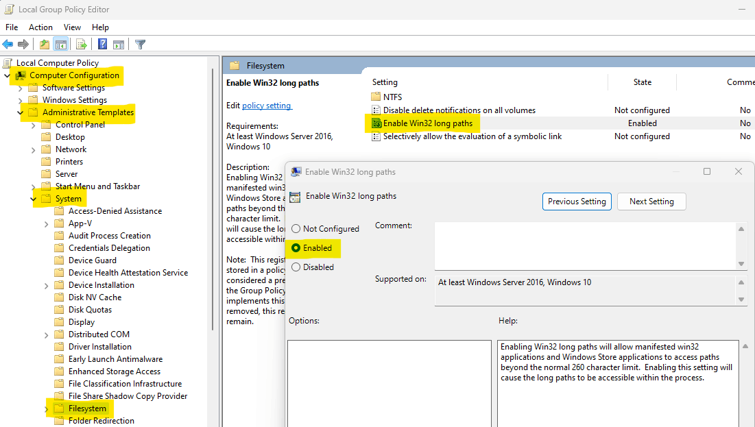

Initially, I got several linking errors due to Controlled Folder Access protection using the Ransomware protection built-in to Windows Security. I whitelisted ar.exe and as. exe, but the errors persisted. I even turned off Ransomware protection. Seeing a thread online about long file paths reminded me I hadn't enabled that on Windows 11 yet (fresh install), so I changed the following settings and rebooted the PC:
Registry: HKEY_LOCAL_MACHINE\SYSTEM\CurrentControlSet\Control\FileSystem\LongPathsEnabled set to 1.
Group Policy: System "Configuration>Administrative Templates>System>Filesystem>Enable Win32 long paths" enabled.

    I did all of this - simply type GPEDIT in the box and run "Edit group policy" For me, on windows 11 pro, ver22H2, OS build 22621.1702 just so ya know I'm current.

    So simply put - I try to drag it all from an external hard drive over to my PC - and it barfs on about 3700 files that have this issue. In spite of GPEDIT... and i also checked regedit, of course its the matching config, this was successfully saved etc. With this many files I'm not going to be able to manually figure it out... so instead i had to go relatively deep into the file structure and copy subfolders that contained the offending files... and then save it all non-nested, and then someone will have to recreate it later. I sure do love this sh*t :)
    and if you read the fine print "enabling win32 long paths will allowe manifested win32 applications... to access paths beyond the normal 260 character limit" what is a "manifested process" ?? seems that "copying files" or "making folders" or "viewing contents of these folders" is not something "manifested" ??
