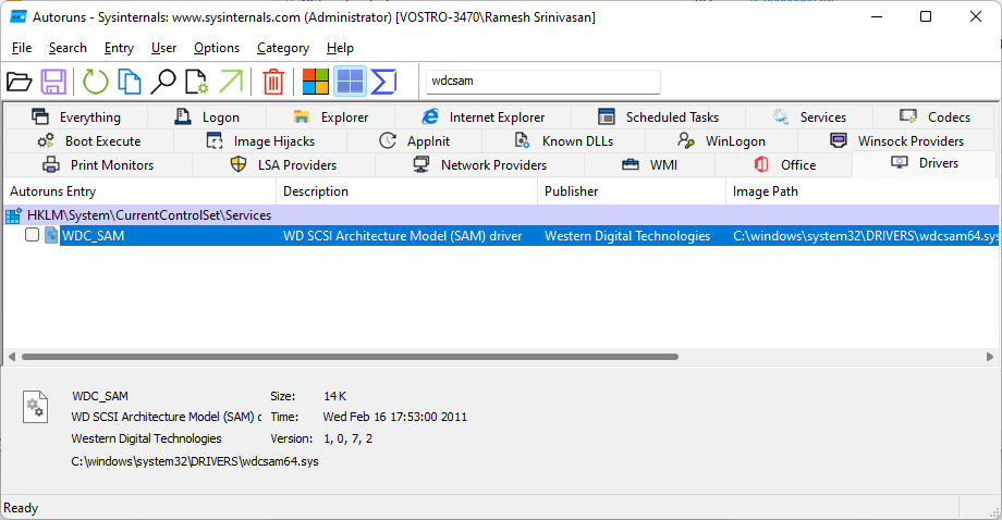

Hi Stephen,
Download Autoruns from the Microsoft Sysinternals site, and run it as administrator.
In the search box in Autoruns, type the driver file name "wdcsam64".
If wdcsam64.sys appears in the list, right-click and choose Delete. Image

    2022-09-04T06:51:49+00:00
    Thanks Ramesh. Ran that as instructed and has solved the problem.
    2022-09-04T06:53:33+00:00
    Hi Dave. Thanks for taking the trouble to reply. I'll keep that command in mind. Useful. Strange though that it didn't show up that WD driver, wdcsam64.sys. But as I said to Ramesh above, running Autoruns fixed it. Hope this helps others with the same problem.
