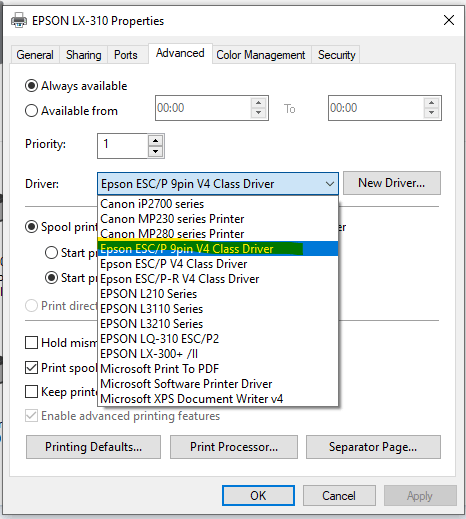

    (all cases using windows 11 pro ver. 22H2)
    If all the instructions that I mentioned above have been done but still can't connect, you can try the next method, which is to uninstall the printer driver and use the driver from Windows update. the method :
    1. Remove printer from device and printer;
    2. Uninstall printer drivers;
    3. Turn off the printer, then turn it on again so that it is detected automatically, or restart the computer
    in some cases, especially dotmatrix there are conditions where you need to change the driver to the class driver type as I attached :
    good luck...
