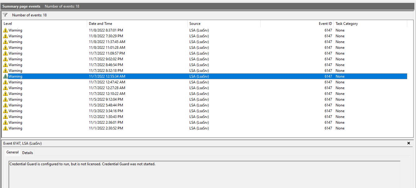

    Each time my PC boot I also have 10 event Warnings ID 6155 "LSA package is not signed as expected. This can cause unexpected behavior with Credential Guard" with the paquets: msv1_0, sfapm, schannel, wdigest, cloudap, pku2u, tspkg, msv1_0, kerberos, negoexts.
    And I have an event Error ID 28 Kernel Event Tracing "provider {77811378-e885-4ac2-a580-bc86e4f1bc93}. Error: 0xC0000005" that seems related with the warning because it is caused by the running process Lsalso.exe (Credential Guard & VBS Key Isolation"

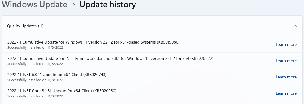

    I just completed doing windows update 2022-10 Cumulative Update for Windows 11 Version 22H2 for x64-based Systems (KB5019509)
    After reboot, these events are still occurring
